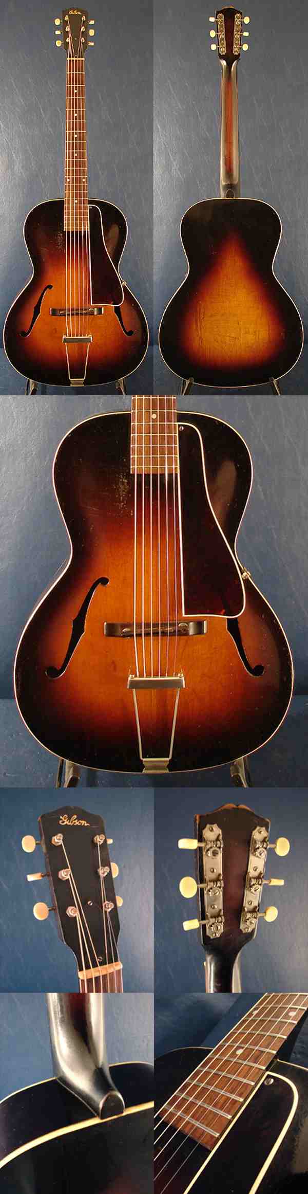

Here's an example:
1938 Gibson L-37 archtop acoustic.
Here are the technical specs; The nut width is 1 3/4", the neck width at the 12th fret is 2 3/16", and the scale length is 24 3/4". The action at the 12th fret reads as follows; Bass side 5/64" and treble side 4/64". The body width at the lower bout is 14 3/4" and 10 1/8" at the upper bout. The body depth is 3 5/8".
The back is NOT carved

Hi Crow,
I'm very familar with these. Richard Brooker, who did my art work for 'A Tale To Tell', has an L-37, and a student of mine has an L-47.
They're different sounding that the Martin attempts: Not as resonant, but actually more even sounding with more sustain than the Martins but not as loud.
All in all.......The reason they don't make them anymore is pretty straight forward.
Now.......That having been said.........I happen to enjoy odd sounding, old, instruments, especially when they are really L-00's in vague 'disguise':-)
As long as you don't have high expectations, or you want to put a magnetic pickup on it, they can be a lot of fun.
